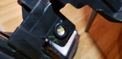

Permanent fix for your loose fog lamps. If you buy new, it will just happen again. Purchase four 1/2"×5/8" rubber grommets. Drill current 1/2" holes in fog light housing mounting bracket into 5/8" holes. Insert grommets into holes and reinstall fog light housing starting with the bracket side with two holes. The grommets will act as a dampener t ok breduce vibration while also protecting the plastic from additional wear. Takes less than an hour and while your in there anyway replace the stock 9006 with a set of 6000k led 9006 bulbs.
