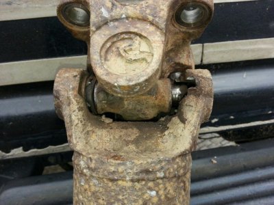

Def check the rear ujoint
This is what mine ended up doing. Funny thing is, when u grabbed the driveshaft and tried to move it, it was solid. Come to find out, it was bound up. So def check the ujoint. Cost me $93 to get a new yoke welded on my driveshaft.
Sent from my SCH-I605 using Tapatalk 2

u-joints would be my first/cheap check on fix on it the heavier rims might have stressed them. mine did it only when slowing down and starting off shortly after new tires. if that's not the problem then id check the dif as said before cuz if so you really wanna catch that asap before it gets nasty
