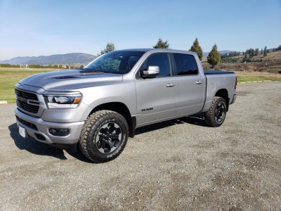

12 inch and no problems.. but mine was built in may of this year. I know that the 12inch is more expensive in the 2020s, dont know if something changed. I love mine.20191011_133124.jpg
