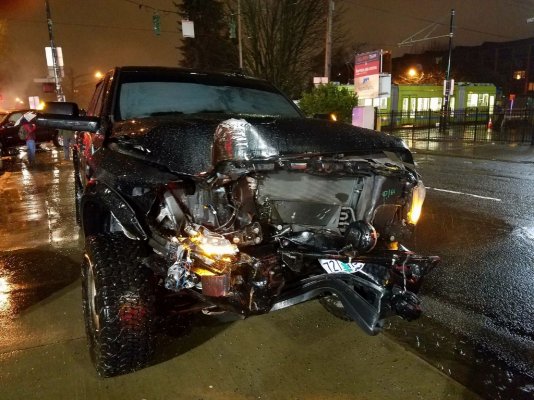

Honest...check out the Morimoto kits. I've had them on three trucks and I've not had one fail me...well, except for this pair:

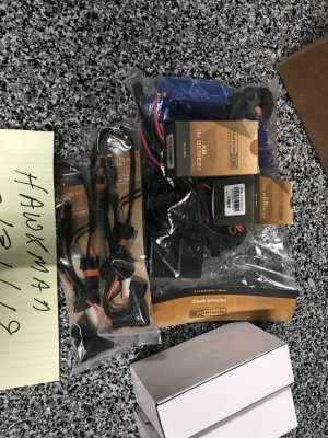

I have a HID kit for projectors available in the “For Sale” section.
Make me an offer, it’s brand new never installed.

The site says the bulb is the XB 9012. Above is a picture of the boxes containing the bulbs. The box is marked “H Series” but I am fnot sure if it’s the H-1 or not. Jeremy of RetroShop, who sold me this kit, is a member of this forum. If you send him a message he can advise if this will work in your aftermarket system.
