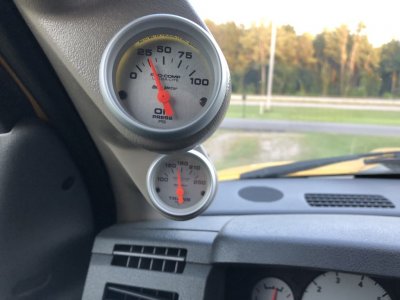

I own a 07' Quad Cab 1500, rwd, 5.7L Hemi running AMSOIL 5W30XL engine oil and a Mobil 1 Performance synthetic oil filter. I turned MDS off about 4 years ago. I also have a AutoMeter Oil Pressure gauge installed at augment the stock oil pressure gauge. I also have a AutoMeter Transmission Fluid Temp. gauge to monitor the transmission temperature.
