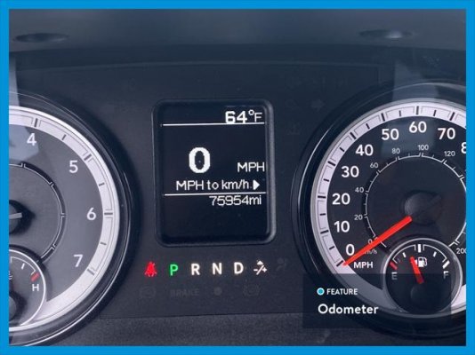

You never mentioned how low it is.
So, how low is it? Also you said for 10 sec or so, how much pressure after 10 seconds?
next time I go to start my truck I will bring up the oil pressure gauge and see what it says I don’t have a oil pressure gauge
I have to go through the settings and bring it up first
2017 Ram 1500 Express short bed crew cab 5.7
in the center of my instrument cluster in between the MPH and Tach it said low oil pressure
this is what my instrument cluster looks like
I am retired and I don’t drive it every day I bought the truck 2.5 years ago it had just over 28,000 miles on it now it has 38,000 miles on it so what weight oil does everybody suggest I use in it I have been using 5W20 full synthetic oil with a Wix XP oil filter
