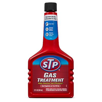

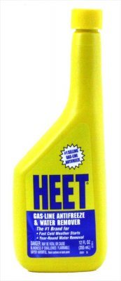

fengfeng, like some of these guys have mentioned, if you can't get a winter blend gas, then maybe you need to look into adding a store-bought fuel additive like Heet or STP Fuel TreatmentHeet.jpg STP Gas Treatment.png
