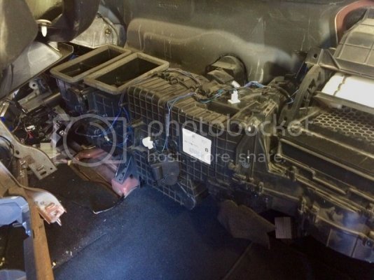

Get yourself a USB bore-scope and look down the vents and in through the blower.
It would be the evaporator​ that could be plugged, the condenser is in front of the radiator.
Ramzaq
Oct 27, 2013
443
114
Northern California
2009 CC 4X4 3.55 Big Horn
The evaporator is right behind the white tag on the HVAC unit and a little to the right, almost were the HVAC unit bolts together. It is higher than the heater core which is to the left and lower. You can see the angled smooth plastic below the hanging door motor. Any wash will go down there and possibly out of the lower vents.
Check out this 4 part you tube video, it has a lot of excellent information. It is mainly about removal and repair but it is about a plugged up evaporator.
https://www.youtube.com/watch?v=dWCjuXxBhlY&list=PLM_FgFcXdM5otFEcZHIN5hamPS3w8pcxR&index=26
Video #4 is the evaporator.
