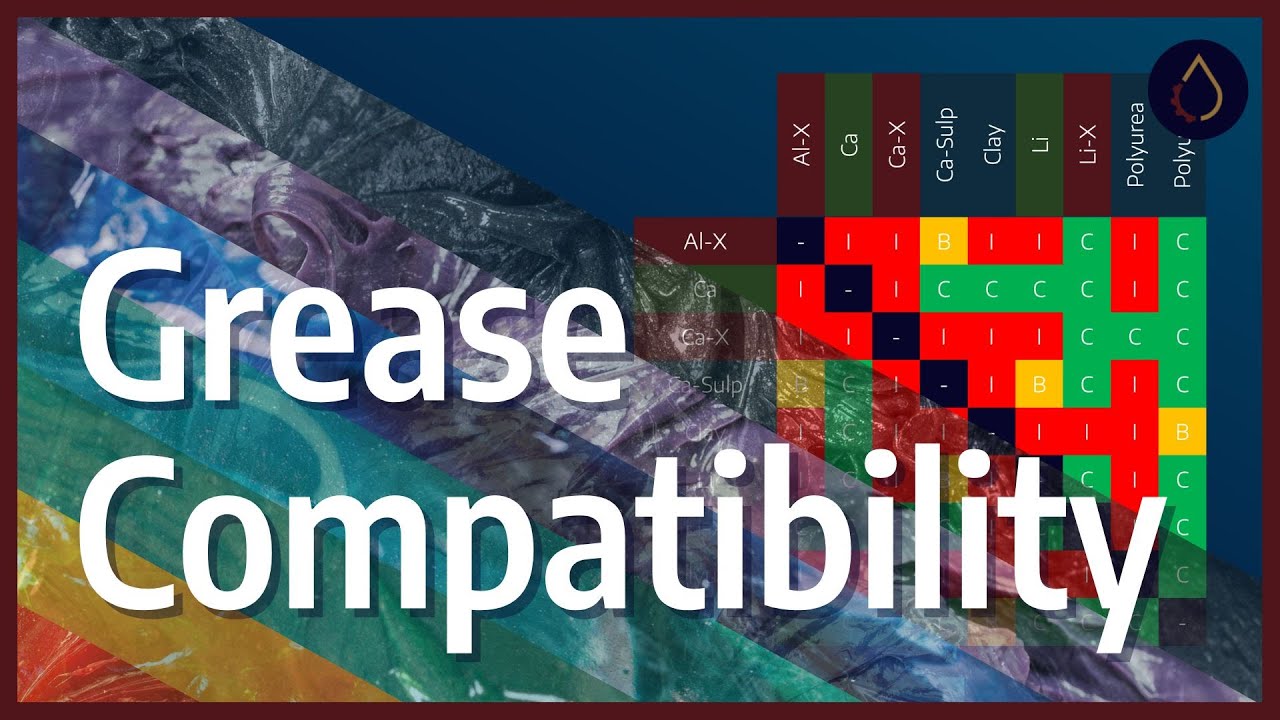

At the other end of the spectrum is you take it to a shop for an oil change and some guy puts a few pumps of grease in it. You may not even know he greased it or what kind of grease he put in it. Grease bases aren't all compatible and some can make other's 'watery' where they lose their lubricity. That shortens ball joint life.
Years ago I took an older vehicle to a shop for some work that had nothing to do with oil work (I think it was exhaust) ...and they pumped all the zerks full of a white lithium grease. Yeah, the greases didn't mix well. I had to pump all new grease through them. If an owner only takes his vehicles to a dealer, they all use the specified Mopar grease ...so that shouldn't be a problem. But let's say you're on the road and a heater hose breaks and xyz shop replaces it and 'does you a favor' and greases your truck (assuming it had greasable joints). You've always used a certain type grease and they put in some green $1.50 a tube grease ... then it's a wait-n-see game.
