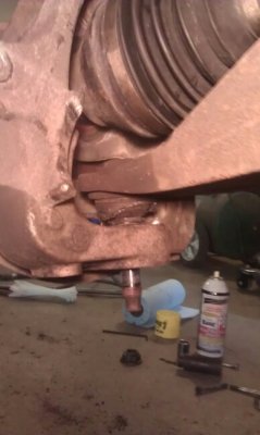

But if you must hammer your truck then you must heat the **** out of the joint till its red hot then it will come out with a ball peen, after that you need to press it in (Svc-Kit consists of a c-clamp and various short hollow pipes). Edit: You will need to chisel out the Ball Joint retaining flange First?? as that is stopping the ball joint from going up and out (yes the one in the Pic). you can see the plate with the rivets I spoke of as well in the pic.
This is a big Job and unless you have had your shafts out I would put the difficulty level at a 7 out of 10. You will have to off the Tie-Rods to get your shafts out unless you undo the upper Joint too!
Good luck getting the control arm off in re-usable condition though (Bushings that is) if you go route B.

I got the spindle seperated and have the press kit but cant press it out.. Is this the piece that you have to chisel off?
ybnormal70
Jan 6, 2012
159
2003
Yes, there are I believe 4 little tabs that are pressed around the edges that hold it it. They are pretty small and hard to see, clean it with a wire brush and you should see them.
