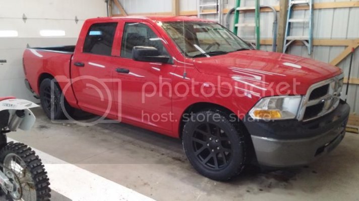

Who would lower a 4wd, that's just dumb... KIDDING. I love my lowered 4wd. Every hillbilly lifts one, be different. I believe a 2" drop shackle should be a 2" drop on a second gen, either 2 or 4wd. The height difference is in the spring.

If I cut a coil off the front spring would I need more then just the shackles in rear you think? And to you ohiogrown your truck like nice. You should color match your grill and bumpers though!
