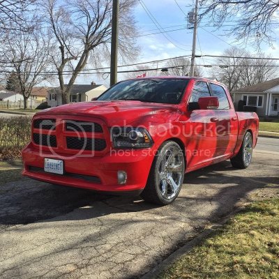

On air......I run much lower then 5" and with 45 psi i rarely bottom out
My ride height
