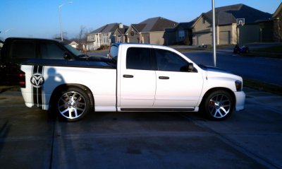

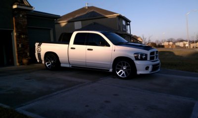

@Shostopper, the truck you're talking about, is that white Gen 3 a 4x4? If it TRUELY is then that would be. Perfect 4/6 drop. I was wondering if you measured the truck before n after reason being is that in the Gen 3 4x4 like mine where the front coils sit in the cup on top is actually welded lower on the frame then the 2 wheel drive rams to be higher so with an actual 4/6 drop I would think it would be less then 4".
Hopefully I can get mine to sit like yours.
4" is 4". That being said you are correct about the Coil cup placement. The truck will still sit higher than a 2WD but would drop 4 inches anyhow. The one thing to be careful about is the front Axles.
