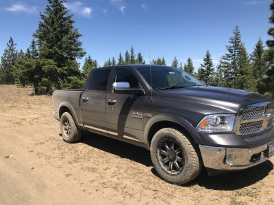

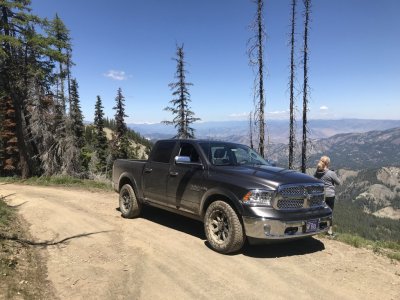

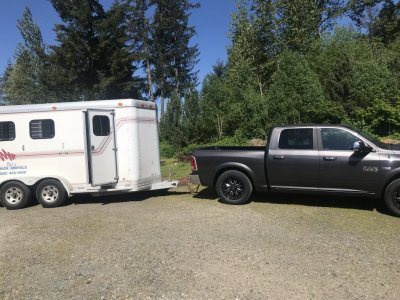

FWIW I stayed with P Metric tires, Toyo Open Country AT II. Was all over Washington State this summer on back roads and Jeep trails (mild) with no problems. This after cutting one of the Goodyears on a forest service road the year before.
I still get nearly 19 on the open highway and was able to slog through sloppy snow back in April. Also, no issues pulling 2 horses.
I nearly got the KO 2 tires, but for my needs the Toyo did the trick, plus the Toyo tires have a 60k mileage warranty.
