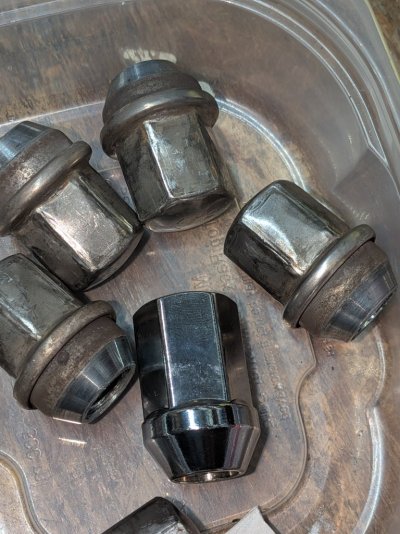

I'm not an expert on this since Acorn/taper 'sounds' similar to me but the terminology that seemed to match up best in my opinion was ... 60° "large (or extra large) cone seat" and in my opinion you need to be able to see actual dimensions of what you're buying to compare to the OEM lugs.
>> The Gorilla Lugs seem to hit the mark across the board <<
Note:
>> the RHI and McGard brands did not have the correct "Large" cone seat and would have likely pulled into and possibly though the aluminum rim seat at some point.
I'll copy/repost my pictures from the other thread here for reference: (Post 45, Post 50, Post 52 & 53)

Mpgrimm2, thank you for your help with this. I took off two of my lug nuts to compare. One that is probably factory, because of the chrome cap, and one that is solid metal. Their dimensions are identical. The new ones I purchased are way too small.
I looked at the 66148FS on the Gorilla web site, but I can't purchase them because I am blocked from adding them to the shopping cart, and no one near me sells them.
I found some on Amazon that have the same dimensions as mine. I will order them and see if their dimensions are correct.

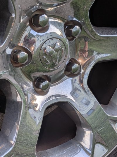

Replaced my stock Lugs on stock wheels (2016 Laramie 1500 crew) yesterday with Wheel Accessories Premium chrome (I wanted the thicker plating). Amaz descript:
Wheel Accessories Parts 20 Pcs M14x1.5 14x1.5 Thread Premium OEM Style Lug Nuts 1.65" Long Chrome 7/8" 22mm Hex Fits Jeep Wrangler Gladiator | RAM 1500 1500 Classic | 6509422AA | 611-330​
About $40. I used a 15/16" impact 6 point Deep socket with 3 plastic shims (3/4 x 3/8), 2 in the V at the base of the socket and one near the top on the lug. A dab of vaseline to hold em. Shims were PVC from white trim or J channel about 0.040" I'd guess. Didn't want to buy a flip socket for one use... or do the 'return it' thing. I did go through about 10 of the little shims. New lugs were high quality threads and shine. Torqued to 130. no issues. 2016 Ram 1500 Lugs stock wheel1.jpg2016 Ram 1500 Lugs stock wheel2.jpg
