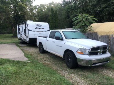

I have a 2012 1500 quad cab sle with the 4.7 and 65rfe. We bought a camper last summer and the rv dealer thought the tow capacity was 7500lbs. Turns out it’s 6050. Our camper is a 27’ tip to tail 6500gvwr. The truck does the job. But I can tell she doesn’t love it. I try to help by using manual mode to downshift on hills. I don’t feel like this trans shifts at the proper times. It’s very doggy on take off. Doesn’t downshift on it’s own till I either floor it or loose 5-8mph. My question is. Can I just change the shift points of the trans? And can I make it so the shift points only change in tow haul mode. I am not trying to get the engine to make more power. I just want it to manage the power it does made better. D32293D1-D4C0-4EE2-B960-2BF69C34A33C.jpeg

Highly recommend a tranny fluid flush, sonnax line pressure booster, and yes, a tune will help, but a line pressure booster will give you more snappy shifts. I’d also recommend a Sonnax rebuilt valve body. Yes, you can get a shift kit and change when it shifts, too.

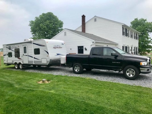

I traded a 2004 1500 with the 4.7L and 3.92 gears last year. Several years ago I purchased a super chips tuner for it. It changed my shift points and the truck pulled a 5,000 lb TT well enough to 55mph. Without the tuner it shifted noticeably harder. The tuner made it bearable. My best upgrade was trading that truck for a 2500.
Hopefully you find something that makes enough of a difference with towing. I also found air bags took away the sag and provided a smoother ride while towing.
