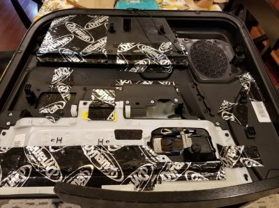

PRRAM
May 22, 2017
51
14
2014 Laramie Limited
Use dynamat that's what I did.
