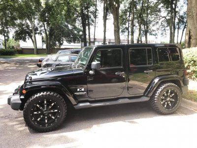

I'm setting her up so I can install a set of ion 184 series in the 20x9 configuration, I don't know the offset on the wheels as the seller didn't know but they where on a 2008 rwd wrangler with no lift of any kind and the 33x12.50R20 repulsor tires have no signs of rubbing.
The only configuration I have found for this wheel that has the 5x5 bolt pattern while being 20x9 are either 0 offset or -18, I understand 0 offset is like factory wheels and that normally a -12 offset is good but haven't really found much on -18.
Although I'm inclined to think that by the looks on the fitment on the Wrangler these are the 0 offset ones.
Attached a picture of my Ram and the Wrangler with my "new" wheels lol.

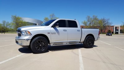

My vote, Maxtrac. Ive had 2 trucks with their kits, never an issue, and their CS is awesome, AND, they are on this forum as a sponsor and here , to me that speaks loud for them as well.
and on my leveled 2015, I did 20x9 with 0 offset, and a 285/65/20, which is a 34.5" and no rubbing

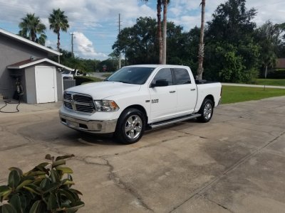

that level I had crappy spacers, then went full 4.5" and 3" rear, with their shocks.
My white 2019, 4.5/3" with Fox shocks.
The spacing out is barely noticeable.
If you dislike, add a Bora spacer for the rear.
