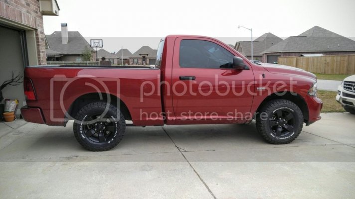

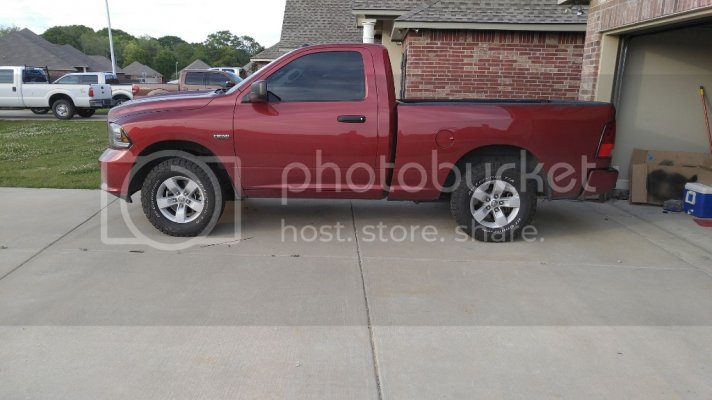

Well here's my update. I had installed some crew cab springs on my regular cab truck and it gave me somewhat of a level. Unfortunately the springs settled like crazy. From about 38" from the ground to the fender to 36". This first picture shows with the front springs in their settled state and with some cut rear springs so I wouldn't have crazy rake.
Well after finally getting fed up with the rake I decided to follow Nick and install some Daystar 1.5" spacers. I figured that the springs in their settled state would get me to about a 37.5" inch front fender height. I was happy with that. Wrong. Very wrong. I installed the spacers and after it was all said and done my fenders were at about 38 1/4" with stock shocks. The ride with stock shocks was TERRIBLE. It was like driving a boat it was so bouncy. I decided to try my Maxtrac shocks and to my surprise (stupidly), the fender height went up to 39"...
At this point I was sitting about an inch higher in the front. I could not have that. So uncut crew cab springs went on.

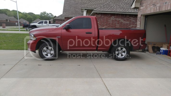

The truck looked great but I was getting coil bucket contact like crazy. I knew if I had it set up like this much longer some new upper control arms would have to be ordered soon. So today I decided I would try to get regular cab springs back on the truck (which I don't have). While I wait I decide to cut a coil off the front springs to lower it about an inch and was hoping the ride would be better with the stock shocks.
Thankfully the ride is WAY better and not bouncy at all. As you can see from the picture above it still looks pretty level and has about a inch rake. I plan on putting some regular cab springs on it with the spacers and some Bilstein 4600 shocks and then I'll leave it alone. I need some bigger tires though for real. Sorry for all the numbers and the cut springs are only temporary so no need to explain to me about the negatives of cutting springs.:roflsquared:
