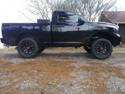

I like the truck, I have a question though. On most trucks when I see a body lift there is a big gap in between the bed and the frame of the truck. You don't have one, which is good but I was wondering why you don't. That gap is what has kept me from doing a small body lift in the past

I believe he is using the optional gap guards that performance accessories offers to compliment the body lift. I run them on all my trucks they make the body lift look a thousand times better IMO

Okay that makes sense, because to be honest I think the gap it creates looks terrible haha, thanks for the response
Sean is right, I do have the gap guards but only up front. I do not have anything in the rear. Our trucks are the BEST at hiding body lifts, that's why I speak so highly of them. Honestly, the front gap guards only covered a small amount of engine exposer and you would be completely fine without them.
