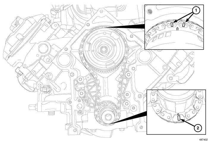

I purchased an AMS racing mds delete for my 14 Ram (ams cam, lifters and diablo tuner) installed the kit and re-assembled everything. I installed the diablo tuner with MDS delete option and started the truck. it barely started but did run, ran like trash and stalled. tried again and wouldn't start. if i keep rpm above 1500 it will run but sounds like timing is out, threw one code p0300 for random misfire. checked compression of all 8 cylinders and have about 180psi -200psi. timing marks were installed with cam phaser at 12o clock and 2 marks on chain with mark on gear centered, and crank gear at 6o clock and 1 mark on chain with 1 mark on gear. Is there anything i may have missed anyone can think of??
POSTED BELOW IS THE DIAGRAM I USED FOR TIMING

The position of the gears lined up with the chain markings as per the drawing looks pretty straight forward. What I don't understand is what happened to putting #1 piston at TDC before sliding in the cam? Seems in the videos that people just slide the cam in and rotate it at will. How do you know the right lobe is in contact with the lifter? Sorry if it's a foolish question.

Cam is keyed to the gear. There’s only 1 position it can possibly go on. But I did check TDC CYL1 and made sure both valves closed. Truck runs great just sounds like a diesel and sets a fault. Guess I’m taking it apart yet again.

Sounds like your timing is 1 tooth off to me, You should have had it on TDC Compression stroke before disassembly, Also check all you push rods for being bent.
