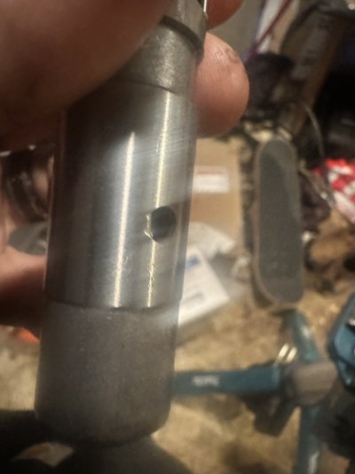

So, I know the pins don’t have to line up with the hole in the lifter, but has anyone had where they can’t see the pins at all? Just re-did the cam, lifters, etc… Fired it up and had a cyl 1 misfire. Turned out intake rod seriously bent up. Turned out brand new lifter for exhaust had no real resistance causing exhaust valve not to open, and to much pressure to allow intake valve to open, resulting in pushrod bending. At least that is what I have concluded.
Inspecting the failed lifter I can’t see the pins anywhere thru the hole. All the other lifters I’ve seen you can glimpse a part of pin.
Any thoughts?
I know those aren’t great pics.

Yeah, my first thought was rod not cupped right. However, I didn’t write what all I did to come up with this theory. When I first found the rod bent I went and bought a single rod and replaced it. Put it back together, checked it was cupped, rolled it over (no spark plugs=no compression) looked good. Didn’t pay attention to exhaust side. I put it back together. And had the same thing happen right away. I took valve cover back off found same exact rod bent. So I thought stuck valve or bad rocker cup? Both were fine. It wasn’t till a rotated motor and saw #1 exhaust valve and pushrod not moving till I realized it was the new lifter. So I was trying to think of why a bad exhaust lifter was causing an intake rod to bend? Has to be the pressure is to much to allow valve to open?
I really want to take lifter apart, but I am trying to get money back for the kit.

So my question would be how are you sure it is lifter instead of the lifter bore, and or lubrication issue on that bore? Do you have the old lifter in that bore, where sides scuffed? I am playing devils advocate, if I was lifter company that is what I would want to know. You don't want to try just putting back a new lifter in that spot? I wouldnt blame you, just asking.
Yes it isnt lubrication issue, it probably wouldnt fail like that so quick if it was.

So the lifter isn’t scuffed up at all, new or old one. I am putting it back together tomorrow, but I will scope the bore, and let you knowI pre soaked the new lifters for hours as suggested. But don’t remember how hard the lifter felt before install, but now I can fairly easily compress lifter, so that was my original question, has anyone seen an MDS lifter where you can’t see a pin at all? You can see pretty far in the hole, but can’t see any pins. All the MDS lifters I have seen you could see the pin somewhere.
Every thing looks good so, I will know more tomorrow. But plan on being vigilant about watching how things move while hand turning over. I plan on measuring movement on intake and exhaust rockers to compare.
