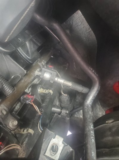

I did the mds replacement on my rebuilt hemi ram 1500 big horn
It wasn't that hard at all and I'm turning 55 this year so an old guy can do it in the driveway
I did do mail order parts ( not usually. But I did this time) I watched the video of a guy doing it on a charger very helpful
I only had problems with the fuel so I just moved the aside ( I bought the cheap plastic toils that did not work out...)
Took about 4.5 hours I went slow
I could cut it in half if I had to as with anything the first time is a challenge. I did break 2 of them so I had to put a screw in it to get it out
The oil galley in the manifold I think I may have to go back and redo the gasket
