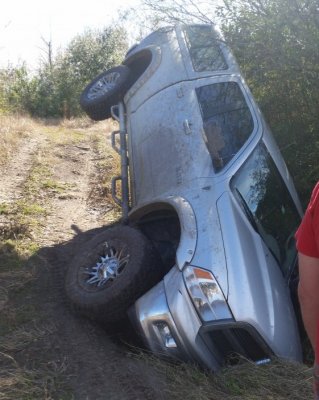

Okay... I finally got around to taking my Bilstiens to have someone install. I had a little off-road accident, and I decided it was a good time to have more done (see photo for your entertainment). I decided to take yall's advice from another thread and get bags. I liked that idea. I roll with a camper shell and a bedslide half the time. All that weight brings the rear down quite a bit. I also pull a trailer a lot. I want the truck to be level with all that weight, and it would be nice to have bags so I can adjust. I had an off-road shop look at everything. The guy there said that you can't install bags in my 4wd 2010 ram for whatever reason (something to do with the design of the suspension setup). I was unclear whether he meant with the 6"RCX lift or at all. He just said my only option was spacers in the back and the adjustable bilstiens up front. He then went on to say that he couldn't use the rear bilstiens that I bought. He said they will not work with the lift. Is he right about all this, or do I need to find another shop. Thanks in advance.

Holy crap dude. How did you manage to run into that hole?
I was just out playing... came over a little hill and couldn't see it over the hood. I like to tell people it was a trap with sticks and leaves covering it up. But the truth is that it was just a huge hole in the ground.

Damn man....after seeing your pic, last thing I'm worried about is shocks. Any damage to the truck?

No major damage. It took a pretty sweet dent (more like caved in) in the driver side rear door. The bumper was pushed in a bit on that side, but nothing a 2x4 couldn't pry back into place. I was surprised too, but that thing took it like a tank. You say you gave the bilstein rear shocks... do you have a lift? I still haven't been able to figure out my questions.
