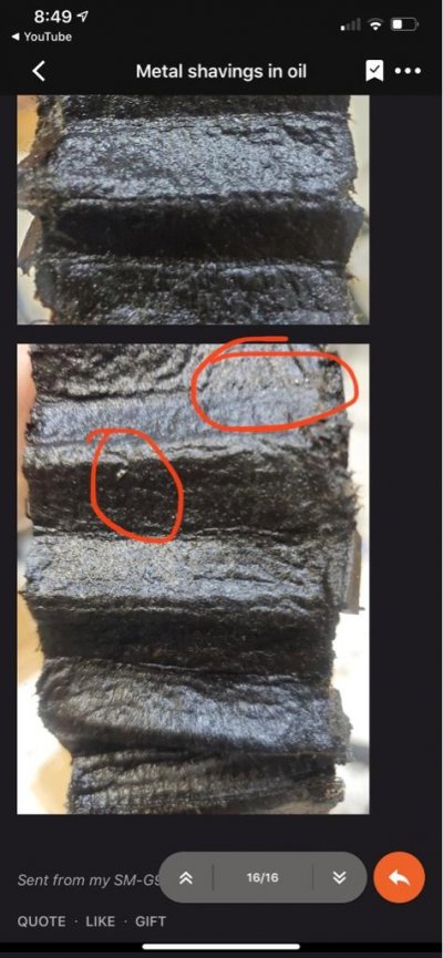

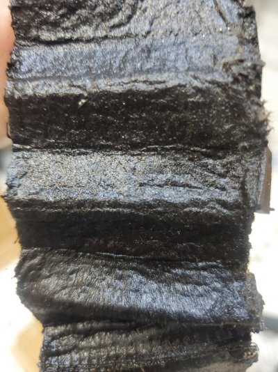

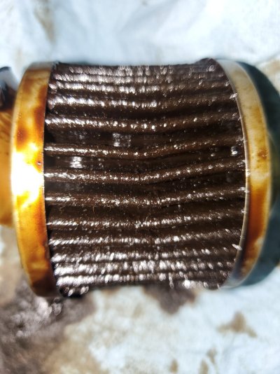

Here is the filter, its a royal purple filter and i have always ran amsoil signature series 1e9a348206d6cd20c441e3b604a92035.jpgf77397433dd23de7294b8df462a43a8f.jpg

Yeah there's definately a few glints in there for sure. Too bad we couldn't have seen the old filter.

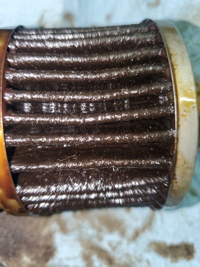

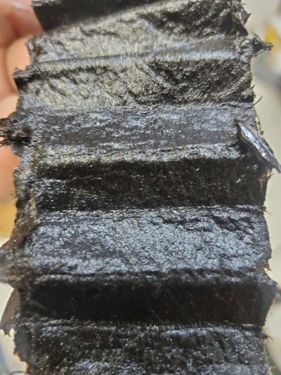

This was the old filter i pulled off a couple days ago. It had around 5k miles on it
Sent from my SM-G973U using Tapatalk
Oh! Ok well there are a few bits in there. I had a few more thah that in mine. Definately do The oil sample see what they have to say. But there is definately metal in There. But I expected much worse to be honest.
