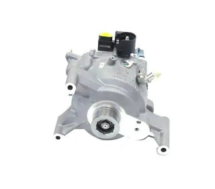

What really sucks is both the V6/8 has the E Torque System with the 48V Battery, but the MGU for the V6 is different than the V8, with different part numbers and of course shows backordered. Why use (2) different MGU's, wonder whom the genius was that did that, LOL. Makes me sooooo happy have straight VVT only, no E Junkola.
ADDED: I get it, turning over a V6 vs V8, wat a silly system, the genius that designed dat stuff, geez, the Ole Don't Fix if Not Broken principle should apply. I sure do feel for the PPL that have these systems, and no parts available, and not made whole.
V6: 68452771AB
V8: 68623194AB

One more update...it appears that the controlling electronics of the MGU is in a module that is bolted to the top of a fairly conventional alternator. So, if the problem is a mechanical issue, it's likely in the alternator itself. These alternators are apparently all the same from 2010-2024 in the 5.7 and 6.4L engines and there are plenty available used ready for rebuild. I just picked on up from LKQ for $79 with free shipping so I'll tear it apart and see if I can confirm the replacement bearings used. May not solve my specific problem but will be an interesting exercise and not cost much.

But as I mentioned above...if the electronics are simply bolted on top of the alternator and together they make up the MGU as an assembly, then as long as the electronics are OK, it should be possible to service just the alternator (replace or repair) and bolt the pieces back together and re-install.
I did verify that the part number for the alternator is the same for eTorque and non-eTorque 5.7 V8; 68422277AC (or AB, AA)

Update - turns out that part number info I got off a Mopar parts website is incorrect. The 5.7 V8 eTorque pn is 68623194AB.
