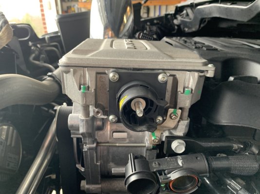

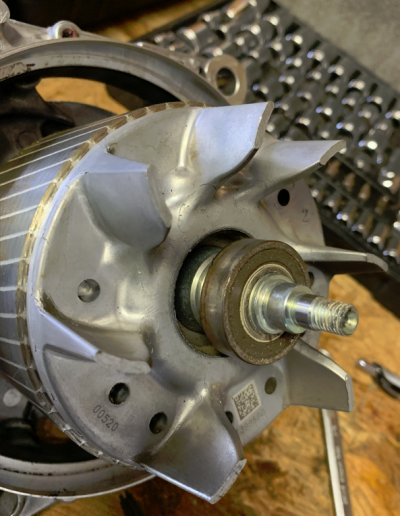

For anyone still coming across this. I was also told by the dealer that these are NOT covered under the 8/80 emissions warranty as well. Furthermore!!! They are charging me $4100 (plus tax) to get the MGU plus install ($1500). When you see online that these units retail for $1600. But I have 2020 with 45k and a failed bearing so...i have no truck to drive and this part is very difficult to source apparently. I've been waiting over 2 weeks and haven't even been given a status. I've seen online some information and even some videos of people replacing the bearing themselves. Anyways. This looks like it will be the last RAM I buy.
The issue with the bearing replacement is whether or not the shaft slop caused the windings to contact the inner part of the case and get damaged. Hopefully you caught yours in time.
