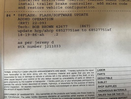

I've read that they tweaked the behavior of the etorque system for '22 models. then they came out with a software update to fix the problems they created. You might ask about an update at your next dealer visit. This is what someone posted on another Ram forum...
