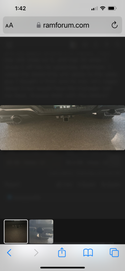

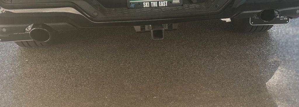

Picked up a new 25 Ram 1500 yesterday. I noticed this morning that the passenger side exhaust is a bit higher than the driver side and the plastic around it is melted. Truck has 105 miles on it, and had 24 when I drove it off the lot yesterday afternoon. I called the dealership and spoke to the sales guy I bought it from and he was very cagey about it but would have the manager call me back. Anyone dealt with this before?

1) I be parked in front of the Big Plate Window at the Dealership talking to the Service Manager. That is a build defect and should be repaired by FCA, which includes relocating/proper alignment of that exhaust and they also gonna have to replace that entire lower right side plastic piece that melted, whateva that may consist of. The sales bum not gonna give (2) chits, he got U to buy the ride.

The service manager will fix it but I would immediately go by and report it and let him see it. If the same as the 23 models, the tips are a ball and socket type connection with a bolt for tightening them. They are easy to adjust but I would leave it to the dealer to do so.

If the exhaust system was in that condition when it was delivered to the customer, it is another example of a dealer service employee getting paid to do a pre-delivery inspection and certify the vehicle as correct before delivery - but didn’t do what they were paid to do.

Looking closely at the enlarged photo of the right exhaust outlet pipe and melted plastic, it looks as though the lower rim of the outlet has a slight “bruise” on it.
Perhaps the truck was backed into an object, pushing the exhaust pipe slightly forward and upward, or was damaged when loading or unloading it from the delivery truck carrier?

Definitely a 2025 with the hurricane. There’s sst badging on the hood, turbos under it, the window sticker says so and a VIN lookup confirms. It is the night edition - maybe that’s why the bumper looks different?
Dealer called back Saturday afternoon - I sent some photos and they said they’re covering it under warranty and should have a replacement piece Tuesday. We’ll see!
