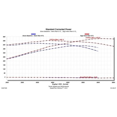

Texas Speed and Performance got me a kit up here to northern Ontario Canada (isolated community) for $3200 CAD and that is for converter as well as everything you need for your install, including shipping! Only thing I had to buy was my oil, filter, and coolant. Now, what I bought extra to replace...
