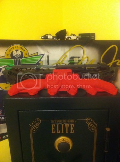

As this week goes on and more parts go in I thought this thread would be the place to list them ..
First is the BD exhaust manifold .. baked it red

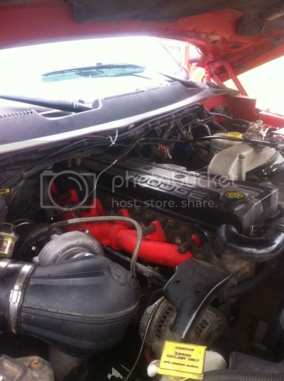

Installed
AFE intake manifold and **** injection install pics coming this week , also the new valve cover and II 120's ... will update soon

nice the first pic makes it look pink

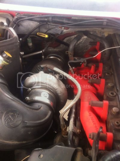

Kenny , I can already feel a difference in the flow . The turbo spools up much quicker now and throttle response is greatly improved . EGT's seem lower also .
I am impressed in this 400 dollar hunk of steel ..LOL I had my doubts but after comparing the size of this one to the stoker I was surprised on how restricted the OEM was .

how did you bake it red?? what were the steps. trucks looking awesome

VHT makes a very high temp paint for 1200F plus applications .
Paint , dry , bake .. 2 steps , 30 min 250F , let cool , 450F 30 min , let cool , then 30 min at 600F ... it cures it .
