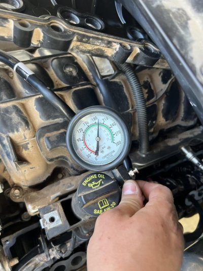

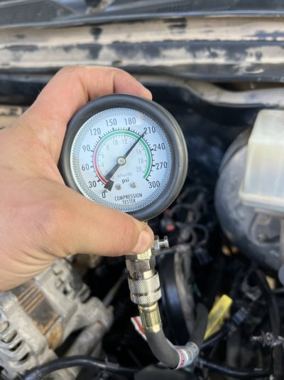

  • Compression test showed 190 PSI on cyl 7 (vs. 210 on cyl 1)

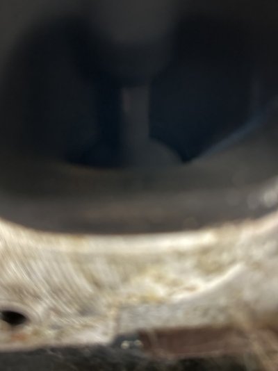

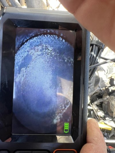

  • Inspected the piston with endoscope camera

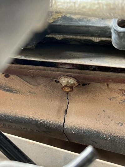

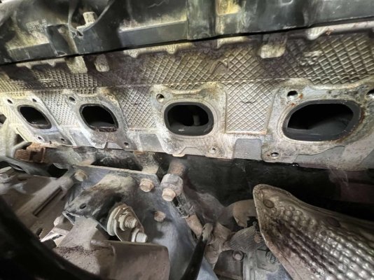

After removing the heat shield, I found a badly cracked driver-side exhaust manifold, likely from forklift damage to the exhaust pipe during transport. I was hopeful this was the cause.
I installed a new set of manifolds from BD Diesel today. While doing that, I noticed heavy carbon buildup on the exhaust valve of cyl 7, unlike the other valves which were clean.

Any ideas or suggestions on what to check next? I’d really appreciate your input. I will post some pictures and videos of some of the things i checked so far.

Before you rip off the head, measure the lift. Can you wiggle the endoscope down and to get a peek at the lifter/lobe? I'd also send out an oil sample. If you have iron or steel in the sample, it's cam and lifter time. If Babbitt, it could also mean a bearing problem. Could be more cost effective to do a full rebuild of go with a crate engine! Good Luck.
