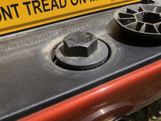

Hello all. I have a 2017 with the Mopar Hitch that has the bumper bolt that sticks about 1/2” up from the hole. It has the rubber cover, but is there a different bolt I can use that sits flush, allowing use of the “flush” plug? Hope this makes sense. Photo included of what I’m referencing.

What size bolt? You can try a round head or button head.

That bolt is part of the main support for your receiver hitch, it needs to be a substantial size due to the forces applied to it while towing.
If you want do away with that bolt from sticking up, you have two options:
1 If you don't need your receiver, remove it and that bolt.
2 If you need your receiver, replace your current Class III hitch with a Class IV

Ok. Wasn’t sure if I could use a flat head socket screw like some other companies use.

Get a Grade 8 bolt of the same thread pitch but a shorter length. You'll need a hex head bolt in order to have something to put a wrench on to torque it down.
Get some flat washers with the proper hole and overall diameters to match the bolt diameter and the recessed area the bolt & washers will be installed in. Make sure the bolt head extends beyond the washer hole.
With the proper length you can sink that bolt head down into the hole on the top of the bumper. Not sure what to do with that cover, though. You might have to carve it up a bit with a dremel to make it fit flush.

I was hoping to use the factory flush mount cover. If I’m not towing anything should it be ok to just leave the current bolt removed...as long as I remember to reinstall before towing? I don’t own a trailer and have no need to tow, unless I borrow my friends trailer for assorted needs.

You need to get a OEM hitch that's the full receiver that bolts to the frame. The one that bolts like you have is a after thought one. I cant see any other bolt options being good ones even if it is grade 8 as that's the main support it holds most of your hitch weight it.

Yeah, I might just pull the bumper bolt and replace it if I tow anything. I haven't needed to tow anything for several months and don't own a trailer...but am kinda attached to my hitch cover :cool:

Do NOT do this. No buttonhead bolt of this size is strong enough to perform what this bolt does. Failure of this bolt might very well lead to an unscheduled test of your trailers safety chains and your composure and driving skills.
