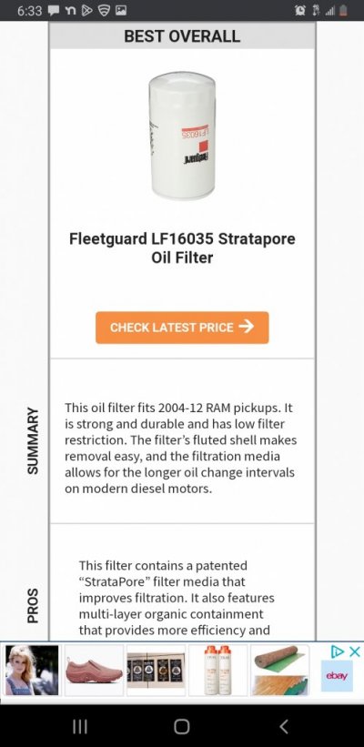

Just curious, my dealership uses Mopar products regarding maintenance for my new truck. My question is, should I purchase the Shell Rotella oil and Fleetguard filters and bring the oil with me when I get the oil change to possibly have them use this recommended oil rather than Mopar products? Does it Matter? Brand new truck only 4000 miles currently. Oil is black, which i heard is normal for diesel engines? Recommended oil change at 7500 miles. I'd like to hear from you all who know of these products and recommend the best choice. Thanks in advance!

Do the oil change yourself..you need an oil pan that holds better than 3 gallons and buy an oil filter plug to make it easier to remove without spilling.
Fleetguard is Cummins filter brand.
Cummins also recommends Valvoline Super Blue full synthetic oil but you can't go wrong with any of the big name diesel oils: Mobil Delvac, Rotella T6, Delo 400 XPS, Amsoil, etc.
