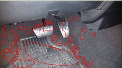

I would to know what the hell is all of this crap I have circled in red below??????....ridicious.
abouttobeglue
abouttobeglue
Sep 3, 2016
651
322
The little circles appear to be mostly dead grass, the larger circles on the floor mat are an area of dried dirt, likely the result of mud on my shoe that once the water evaporated, was turned back into the brownish dirt you see, as those are rubber floor mats that's lay over my factory carpet floor mats that are in great shape. To determine the exact source and composition of the dirt and grass, it would likely need to be sent off to a lab for forensic testing. I'm not a wealthy man, however if you would like to start a GoFundMe account for a forensic diagnosis of what is on my floor mat, please feel free to do so. I must insist that you cover the cost of shipping my floor mat to the facility of your choice, and I would also request that a loaner floor mat be provided to me at no charge. The size and style of the loaner floor mat is not an issue, although I do ask that you provide me with a passenger side floor mat of the same style, as I like things that match.

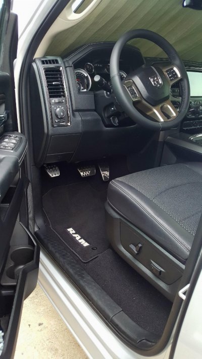

Ok, I got the fix, buy a #6804 8939AA for a 09-17 Dodge Challenger stainless steel clutch pedal pad Mopar OEM.I got mine on Ebay from Steve White motors Inc. for $17.70 shipped.All you have to do is pull the factory rubber pad off, take the metal cover off the new pad and snip off the little nub 2nd row down from the top, 2nd nub from left.Place the metal cover back on.Put a bolt through that hole(I ground the head round to look like the rubber nubs, the painted it black)The metal pedal in the truck has a hole drilled in it's center, put pedal on pushing bolt through hole, put on washer and bolt on back side and tighten.Looks great as a set and works fine.I will post pics as soon as I can.I have step by step pics at Ramforumz site

Glad to see your truck is clean I will be able to sleep tonight...
pedals look good :)

Ha, I vacuumed after the install just so I wouldn't get a verbal beat down when I posted it.:)

bnxjwLI.jpg No, they fit fine, my sport has adjustable pedals and had no problem at all.Here is a pic of mine installed.
