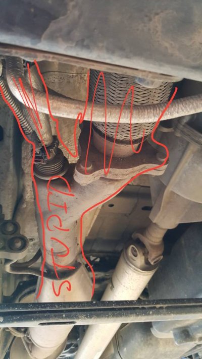

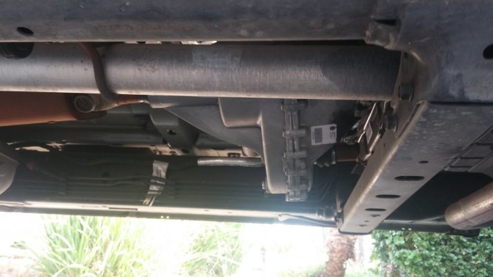

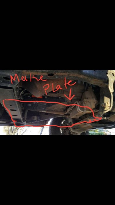

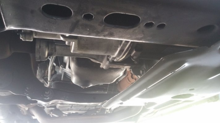

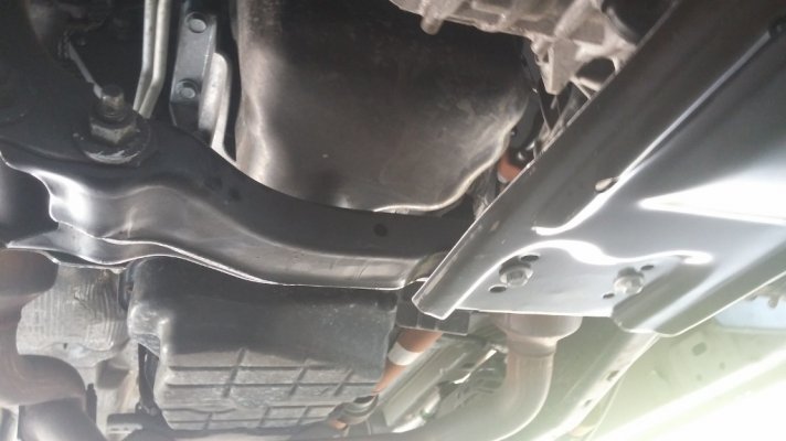

So, ironically you have a thread already about skids....shoukd have figured lol. I was just under my truck assessing things and trying to look at a logical and affordable way to get some skids under it.
First off did you sort this out for your truck. All my crossmember have the holes so it's weird yours is missing a set?? Secondly. Just an idea, but I'm thinking about adding a second t case skid, and putting it next to the existing one as both crossmembers are flat, id be able to get a bit and bolt on the rear most member, than id have to drill and tap the trans crossmember as it's boxed out. But that would pretty much cover the rear of the belly per se and protect my vitals, since I have that fancy exhaust filters that cost a bazillion dollars. Add the front steering plate as I don't have that, than I was looking, I may try and fab a belly plate that connects both, similar to revs setup without making new x members. That plastic trans pan scares the **** out of me and our break over sucks. I think if I got a little crafty I could make one that would work, would be perfect but it would be better than nothing.

So my idea is simple in essence. Add the extra t case plate, just need to drill my own holes. That covers the thing that I outlined as STUPID. Than fab a flat skid that mounts under the main open belly under the trans that installs before the oem skids, that way there's no lips to hang up on. It can stay relatively flat, except a few smaller spots on the front crossmember that would need to be pieced in with small angles. There's already small washers in place, so I don't see adding, say a simple died 1/8" plate being overly intrusive to anything. I smashed the stock skids hard and they took it ok, maybe jump to 1/4" plate even if you wanted. It could garner ample protection for important bits without too much fab.
Critique my thoughts!

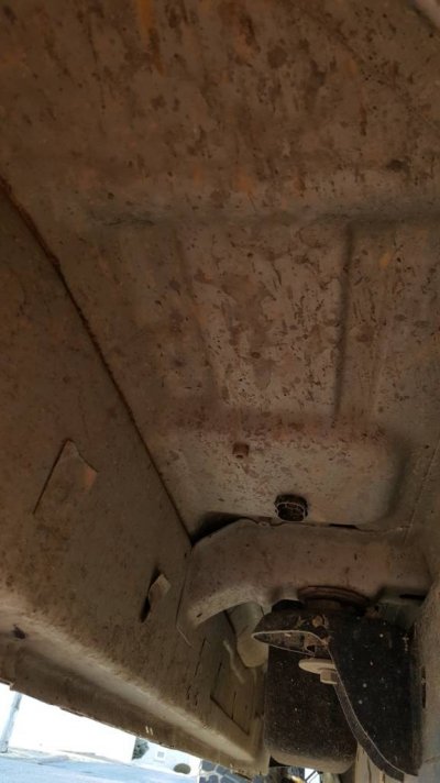

Last pic is why I run these stupid flaps, didn't wash the underside at all, with all the mud I saw this weekend, there was no heavy build up at all, just the silt from puddles like id get from a dirt parking lot. That right there made them worth it, the rebel I was with had so much caked into all the floorboard creases it was disgusting. God bless his mechanic lol. 53d06de5fbbc90d31b6b5525667f3486.jpge6e55cc7e82d0a8ff9b22fb5c67558d5.jpg21f7f8492e198d147ac67a9de82d266b.jpg6b2a2dee32a5982289687c6b20f5b73c.jpgd74c4a2a75dd891a1f29dc782c09e958.jpg9e5edbe029e93b9b8146c2fa18ea7def.jpg
