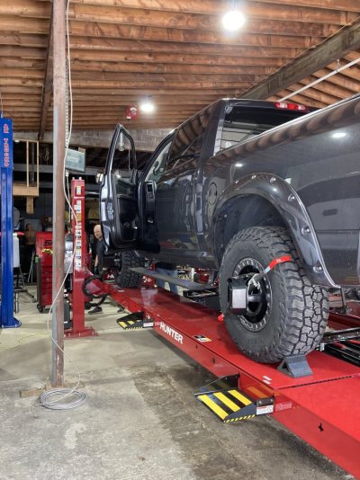

I’m lucky that my trip to Quick_Shifter’s shop, ak_trucks_pa, is 2.5 hours for me & have posted before that I would happily drive twice that far. I look forward to my trips to his shop like going to see an old friend that just happens to be awesome mechanic with old school work ethnic but all the modern tools.
I’m in North VA. but might end up in North Carolina, I would get a hotel room close to his shop & use some vacation days to be able go to his shop, not practical for some but for a shop you can trust completely it is
definitely worth the trip for me!
