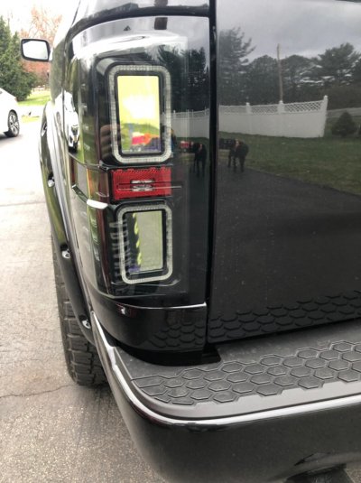

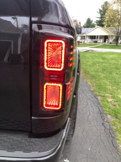

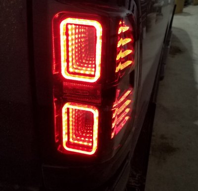

So they finally arrived ! 4 months later . I ordered Jan 29 and they came 4/28! Hooked up and they looked like this ... however once I started the truck to check the reverse lights , I found out the reverse lights didn’t work and the passenger side light stopped working as a tail light and reverse light ..drivers side functions as it should . Both turn signals work as well as brake light. Needless to say I’m a bit irritated but almost expected something to go wrong as the whole wait time was a hassle why wouldn’t the install be as well.....probably will be going thru a bunch. Of hassle to get this rectified . Sent retrofit source a Facebook message as they aren’t open on weekend I probably will have to fall Monday. Please reply with your experience if you have one regarding these. tails . 77054457bcef7c131e3c3998b72142c0.jpg3037c361315564412affdae8bdb1141c.jpg23066672101d25429327babc1b5be87b.jpgad8ce30951b0a196785b3ddf8cd06e62.jpg

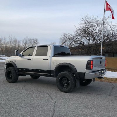

17C59CF4-D5F3-4992-B206-E85DDD53C468.jpeg the only thing that seems to be working is the break lights and turn signals. The running lights on the sides and inside the middle of the brake lights don't come on other than that. Sometimes they randomly do but it's very hit or miss. When reversing everything flickers and turns on/off. It’s very frustrating for me as I connected everything properly and triple checked.
