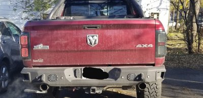

So my passenger reverse light has been blinking and then goin out since I've owned them. I basically gave up on them cause they output such ****** light to begin with. I went with an aftermarket bumper with cutouts for rigid lights. But now passenger side has gone completely out and I doubt it's the connector cause the brake light still works but running light no longer comes on
Damn, hopefully they'll warranty them out and send you a new set

So havent contacted them yet. Been on 12hr shifts so just havent had the time. I stopped tonight to get my mail tho... notice anything?
