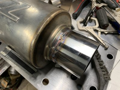

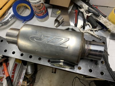

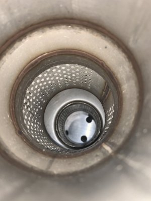

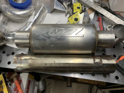

ZZP resonator is 16” overall, 10” x5.5” round case and has 3” ID inlet and outlets and it’s made from 304SS and it’s heavy and very solid. It’s a 3 chamber with a perforated straight through core, inside is a empty chamber and then into another perforated core. Inside is stainless wool and fiberglass packing.

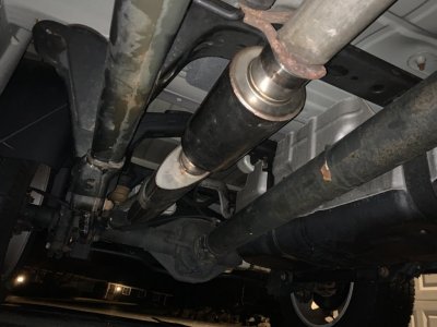

I got it because it needed to be 16” Or less length to fit into the slip pipe in front of my Borla that way it’s like a bolt in 2 muffler section without modifying the stock exhaust. In order to fit all I did was cut the outlet off and weld in a 3” x 3” OD section of pipe into the end to slip into the Borla muffler. Then knotched the resonator inlet to slip and clamp over the stock 3” pipe. 2 SS band clamps (reusing 1 and I have used ones). I painted the outlet I welded on of the resonator as it’s 409SS and wanted to keep it from rusting quickly, used some 500* engine paint.
She slipped right on/in and bolted it all up within about an hour. I was able to only cold start it and it removed a lot of the cold start rasp that the Borla has and slightly reduced the tone at idle. I’m about to take it out for a drive with the kid for errands and will provide feedback on how it’s effected the resonance.
here are some pics of the install. I will update with some sound clips or better pics when I get the chance.

Got to drive the truck today and man did this resonator make a big difference! Drone is essentially gone, resonance is almost non existent and it’s reduced the overall loudness a bit, nice deep tone. Cold starts are no longer overly aggressive.
