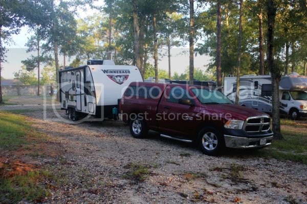

In September I pulled our 4500# travel trailer over 2400 miles with a 2014 RAM 3.6L, 8 speed, and 3.21 rear end. It is a very good towing combination and I do recommend it. 65 - 70 is easy. Besides I get 25 - 27 MPG when not towing. I have no plans to trade for a V8. You can buy a Tradesman regular cab way under the $30,000 you mentioned.

We will start with June. I towed a 6x10 utility trailer round trip from Texas to S. Carolina. the trailer probably weighed around 1400#. On that trip I got 16.5 MPG. In September the round trip to Florida got 12.2 mpg. As you probably realize the cross sectional area makes more difference than the weight. Lots of hills between Texas and Florida and several rain storms. It is going to take just so much energy to move a trailer of a certain weight whether it is a V6 or a V8. I never expected to get great milage pulling a trailer but I accept that every time I pull and I don't worry about it.
