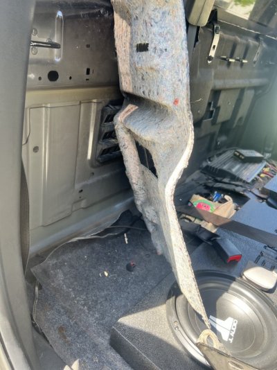

Thanks for the replies everyone. I took out all my seats and found it was entering from the back vents. You can see the tiny paw prints climbing out. F47AD76A-D6FC-480F-97A2-59EEF2D89953.jpeg

Your vent flappes are gone you need to replace them anyways, you would've had water leaking from them, make sure you get them from Mopar they have been upgraded.
