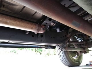

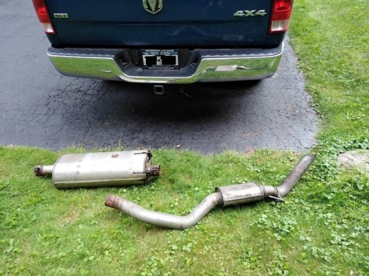

Given the mufflex muffler delete kit is coming tomorrow and I had some time today, I had at removing the factory muffler and rear tailpipe/resonator assembly.
I was concerned about the captive band clamps on the OEM muffler. Two rust belt winters and 37K miles took their toll on them. I couldn't feel a hex on the nuts at first but spraying them down with penetrating oil and scrubbing some of the rust away with a rag allowed a 6pt 15mm socket to fit on. They wouldn't budge with a ratchet, but my 1/2" cordless impact rattled them loose with a shower of rust. They're still usable and don't look horrible with all the rust rattled off. The rubber dongers all slipped off OK once you shoot them with penetrating oil. I bunch of wiggling separated the pipes. As everyone knows, the muffler is huge and heavy. The tailpipe/resonator section is heavy as well. I would guess 40+ lbs between the two? Maybe more.
I ran to pick up a pizza with no muffler and she's LOUD with nothing but the long straight section of 3" exiting about under where the rear seat begins. Wayyyyyy too loud. At warm idle and at easy highway speeds it's not bad at all, but cold starts and accelerating? Hang on to your ear drums LOL! It does sound super cool if you floor it and let it roll through the gears.
I don't have high hopes with this muffler delete. I expect the truck to be louder, but if it's anything like it is now, the OEM muffler will have to go back on.
