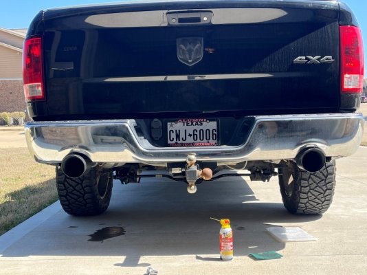

+1 for the Carven Competitor for the best bang for your buck and ease of install in my opinion. I've had this direct muffler replacement and their 5" matte black tips on my truck for over 2 years now, and it sounds perfect when cruising around town and when you want to push the pedal to the metal. I had the exhaust for a couple months before getting the tips, and it's a slightly deeper and throatier sound when at idle. I'm not sure about NY's regulations, but since it's a direct replacement, I don't think you'll necessarily run into issues... especially if you're able to keep your stock muffler and swap it for a yearly inspection. I've passed the Texas inspections without any problems.
