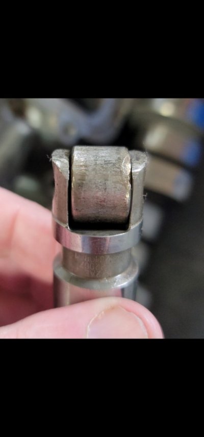

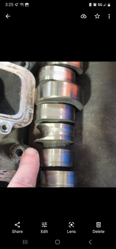

This is my 2011 ram 2500 with the 5.7 cylinder 3 misfire. Ends up the lifter roller grooved the cam. When they pulled the cam the bearings are trashed. They pulled the oil pan and a rod or main bearing finding metal throughout.
Was supposed to be a simple cam and lifters looking like an engine now.
Just sickening.
The options are not good. Pull the block and wait on a machine shop to go thru everything and take weeks. Or get another reman.

There is absolutely no excuse for your cam and lifter to do that. This engine has been in production for 20 years. Totally unacceptable.
It's plain to see the lifter rotated 1/4 turn and ate the cam up.

You've had cam issues for awhile,as you don't wear a groove that deep unless you drove it for quite awhile with the issue.You could of probably got away with just a cam and lifters if you'd addressed the issue as soon as it showed up.Putting off fixing it has bit you in the rear
You're right. Started off with a tick one morning then went away. Couldn't hear any noise from the engine that indicated such a severe amount of damage. I was getting it addressed and went thru the troubleshooting. Couldn't get in to a shop for 2 weeks on a waiting list. Any local garage is covered up with repairs. I baby'd the truck but at the end of the day it was a 3 week debacle.
