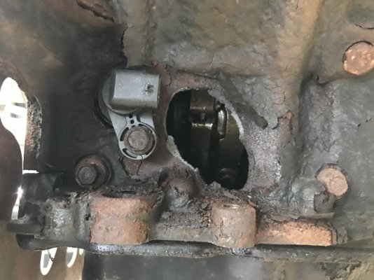

just my opinion but that looks like way more than 3 weeks worth of damage…..unless you drove it nonstop for three weeks.
Also, this is a known defect and not uncommon. Mine was a $3,600 complete rebuild by an engine shop in Tampa Fl

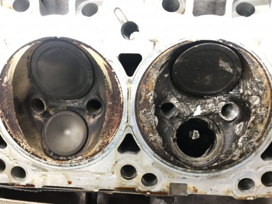

y4mcsSok_5deZXxyKyp8kayx-vM7_BL2tGCim3GvlSApyoEYLfGHOJUEbcL2BOQSbleQ8PyjgoMkr1AWb6xUEGSAFJcpV1...jpgIMG_2214.jpgIMG_2216.jpgIMG_2215.JPGIMG_2212.jpg
I had lifter fail on my '09 Ram 1500 at 140,000; gouged the cam, etc. Buddy is a mechanic, so was able to fix for around $2k. It is definitely a known problem, and for Fiat NOT to allow some $ for customers to offset repair costs, don't know I'll be sticking with Ram..... BTW, after fixing this known problem, 20k miles later valve seat let go(another known problem with the 5.7 hemi) and caused piston to shatter. New engine time.​

Say the intake valve fails and is open to manifold; any metal fragments in cylinder is now going to be pushed upwards into intake manifold ( see my pictures in this thread; my intake was loaded with metal fragments)

Man, those pictures are scary! That's some serious failure!
I believe you, but my thick head still doesn't get it.
If an intake valve stays open, it's only open to the top area of the cylinder above the piston. There is no oil there (compression chamber). Unless your rings are totally shot, how can oil get into the compression chamber? it's just compressed fuel/air mixture. No?

My valve seat failed, got chewed up between piston and head/valves, eventually breaking intake valve off, leaving open hole to intake; piston pushing all this mess up into intake before piston finally exploded. Oil was not in intake

Ah, different story! I mistook what you were saying. I thought you were saying oil contaminated with metal particles got into your intake manifold when actually chunks of piston and valves etc. were forced in there. Dang! That's catastrophic!

Correct! Yea it was catastrophic, especially since I was 600 miles from home. I would hope Ram has corrected these inherant problems before I would even consider Ram again (especially at the prices they want for them now)
