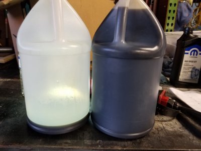

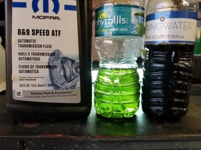

Old vs new fluid:

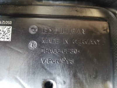

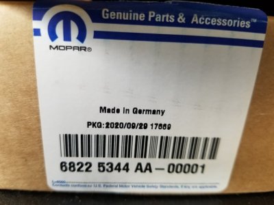

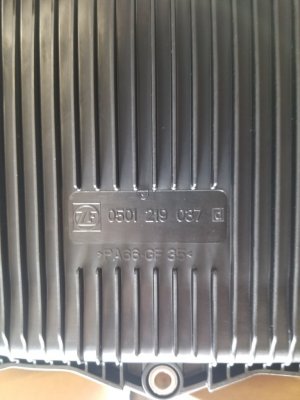

Bought 7 qts. Mopar fluid and Mopar pan.

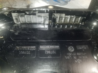

Check out who made the pan:
On the inside of the pan
And on the integral filter:
The outside was marked:

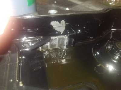

Magnets had some shizzle on them:
Notice Filtran, but made in USA
Side magnet:

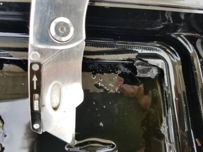

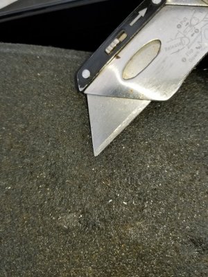

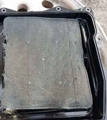

Filter dissection results:
Top side:
Bottom side: some flecks and a couple slivers of bronze.
Bottom of filter housing: Some of this could be small plastic crumbles from me digging out the filter media.
Overall, very happy with results so far.

I will definately want to do another drain and fill after a few k miles as the fluid was a very light greenish brown from the mix of new fluid with old.
I'm sure the influx of fresh fluid helped because it felt smoother to me when I ran to full temp before the last level check.
