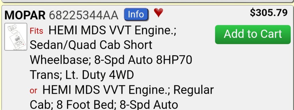

But, look at it this way:
OE plastic pan is $306, PPE aluminum pan is $300 also, or thereabout.
You can reuse the bolts and use the sleeves from the OE pan, and you need a gasket, but the cost isn't that much more. You get 2 extra qts. capacity, too.

Yep, 2 pans available, 1 qt. extra for $329.99 - $349.99, or 2 qts. extra for $319.99 - $339.99 Replacement filters for $29.99.
If the OE is $306 at RockAuto, might as well spend $20 - $40 more and get a known high quality pan.
Then, only spend $30 extra for a new filter for every fluid change after that.
