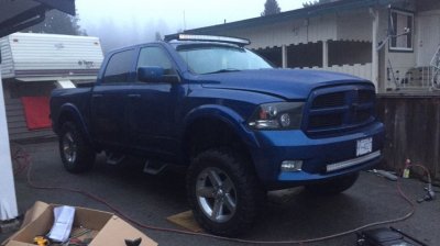

just finished up day 2 of install, not as quick when you install it solo!! I'm running the Superlift 4", wanted to show off a teaser pic of the front done! started the rear tonight but ran out of daylight. install is going ok, biggest pain in the ass for me so far was removing the front diff bolts.. location is less than ideal for access but other than that it hasn't been too bad I've got about 15 hours into it so far, heres my Cali lean :naughty:

That's going to turn out looking really good!! Almost looks like it's a 6".

sorry i should've noted I'm also running the rough country 1.25" body lift, but still came out bigger than i was expecting!

i feel your pain my 6" superlift took me a week to install. The front was the hard part though
What fender flares are those?
those look like egr flares to me

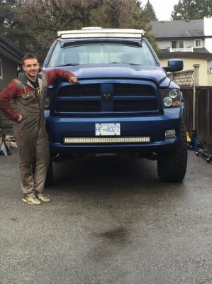

She's done! Ok yes the flares are EGR Rugged style, tires are 35x12.5R20 togo M/T's.. Rims are next! As for install the rear went well, biggest issue was indeed the rear shock upper bolts are a pain, and like i said before the front diff bolts sucked, and the lower ball joints.. and also the electrical connection to the front diff was too short i couldn't get any slack, fortunately enough it was basically like a 2 foot cable that i was able to disconnect, cut and solder in about 4 inches on each wire, shrink wrapped and re wire loomed. All in all I've got about 20ish hours into it and i couldn't be more happy with how it turned out!!!!

That looks fantastic ! You look dead level . Do you have adjustable shocks up front ?
What are your measurements ?

Thanks for all the comments guys! Yes I have bils up front, before the lift I had them at 2.8 and when I did the lift I lowered them down to 2.1, as for level I measure in my drive way I don't think it is level the passenger front was 45.75" and the other 3 corners were 44.75 from ground to fender well

Just give it time for everything to adjust and relax in place. After about 500 or so miles measure again.
