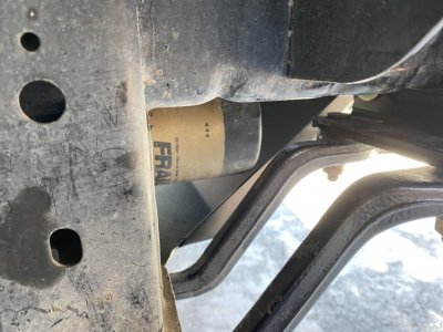

@Wild one do you know if you have an oil cooler? If you have an oil cooler you should have some piping and hoses exactly above the oil filter.

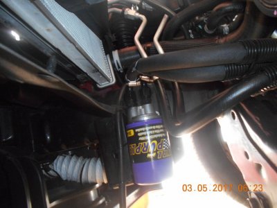

The oil coolers didn't come into play till i think 2018.I run dual remote filters on my toy,they dropped my oil temps down far enough,i quit worrying about adding a stand alone thermostatic oil cooler. Redline 5W-30,alot of us run it with good success
Sweet setup, where can I get one? To what did you attach it? That is awesome! With that setup, plus an oil cooler I bet I could run 0W-16 in my HEMI without any worries :Big Laugh:
It's just a Transdapt dual filter set-up,that i upgraded the hoses on to -10 (5.8"). I did spend some time with a die grinder cleaning up casting flash and removing any internal sharp edges.I'm not a fan of sharp edges in an oil system,i think they contribute to oil shear and turbulance in an oil system.
https://www.summitracing.com/parts/trd-1227

It's just a Transdapt dual filter set-up,that i upgraded the hoses on to -8 (5.8"). I did spend some time with a die grinder cleaning up casting flash and removing any internal sharp edges.I'm not a fan of sharp edges in an oil system,i think they contribute to oil shear and turbulance in an oil system.
Thank you so much for this information. Where and how did you attach it to the truck? I got a 2016, so they are probably identical unless you have a 6-speed transmission. Mine came with the 8 speed.
I just drilled and tapped the frame for 5/16" studs.Only reason i used 5/16" studs is i have a bunch of 5/16" ready rod laying around that i've been trying to use up for the last few years,lol.You could probably get away with drilling and tapping the frame for 1/4" bolts though.My truck is an 8 speed 4X4. I figure i picked up a good 1 to 2 psi of hot oil pressure with the dual set-up compared to my old single remote set-up,and my oil temps took a noticable drop.Old set-up was a Transdapt 1127 kit with just the single remote filter
